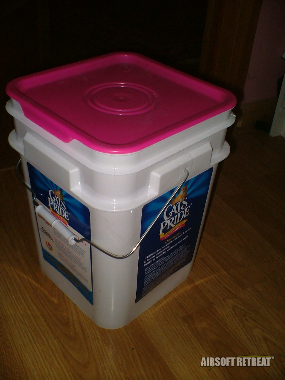

  • a plastic 5 gallon bucket (preferably square)
  • 10 minutes
You start with your plain unadulterated bucket, empty and clean. A square bucket, such as the type that cat litter or some pet foods come in is definitely preferable to the more common round bucket. The reason the square is preferable is that the trap, when complete, will be more stable and not roll about when perched for shooting. This will become more obvious later.

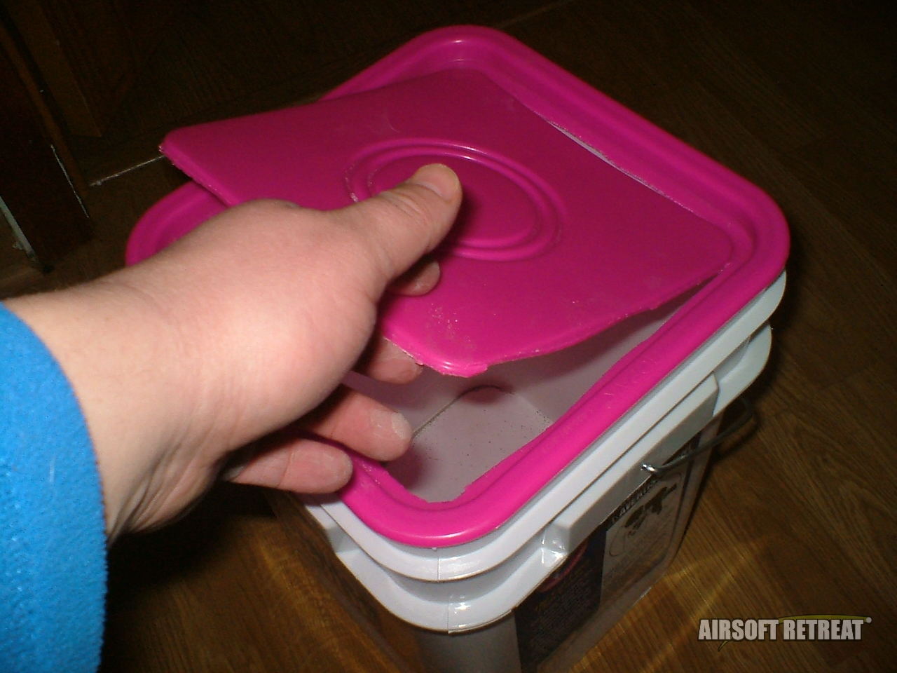

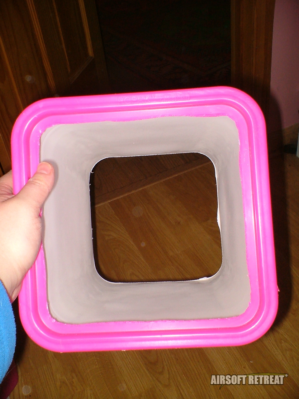

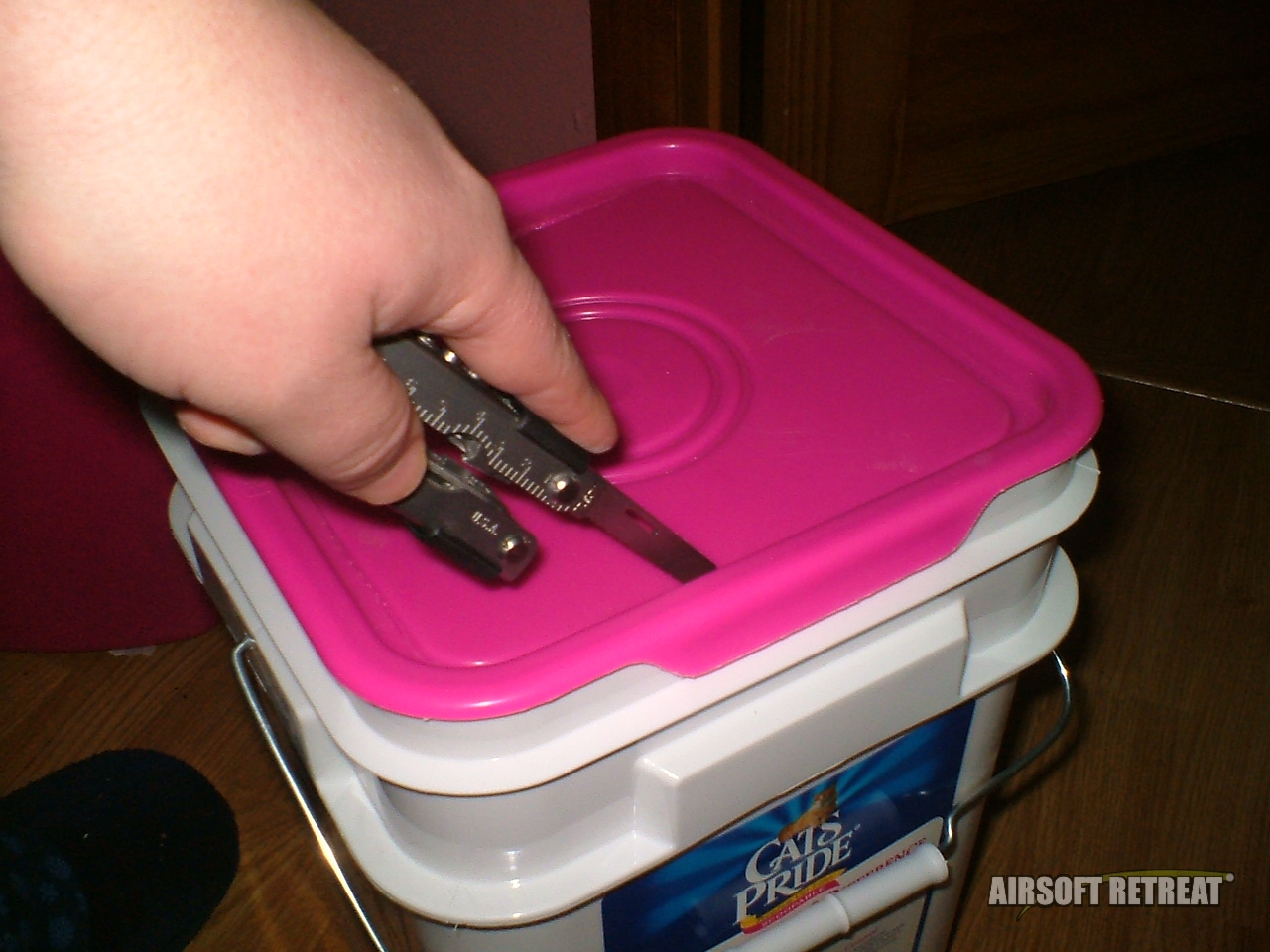

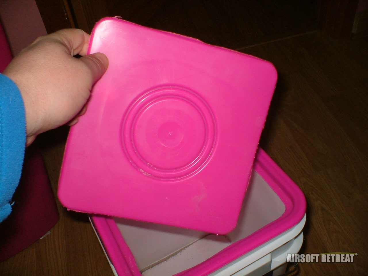

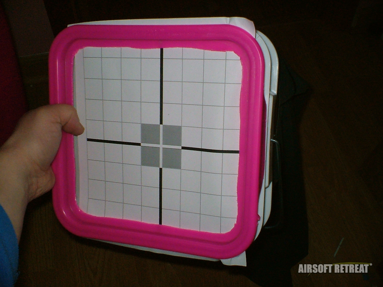

Begin by cutting the center out of the bucket's lid. This will form a 'clip on' frame that will hold the target in place.
Being careful to cut as straight a line as possible, cut along the edge of the lid but not too close, as you want the frame to be as sturdy as possible. Remove and discard the center section.

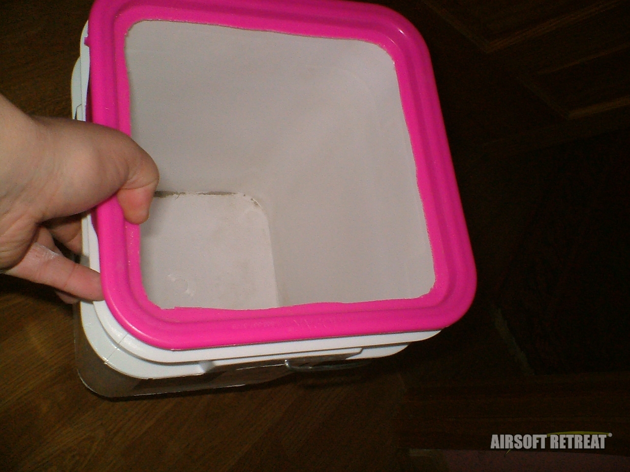

This part is relatively easy. Since the lid bears no real weight, the amount of plastic devoted to its construction is limited. Once the lid has been prepped we move on to removing the bottom of the bucket.

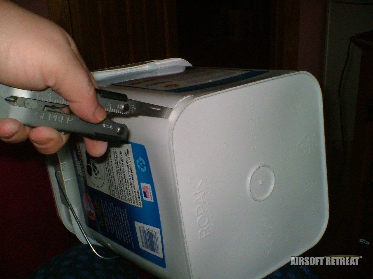

You don't want to cut the bottom out, as that will leave a 'lip' around the bottom that can catch bbs and either damage them (for those of you who like to reuse) or cause them to ricochet back out toward the shooter (while not generally dangerous it certainly leaves a mess in the room).
Once the bottom has been cut away you have a 'tunnel' of sorts. For reasons mentioned before, you should clean up any burrs or lips that are still present around the cut edge. Take a pillow case, preferable of a fairly high thread count for strength, and tape it over the bottom opening, allowing it to hang loose.

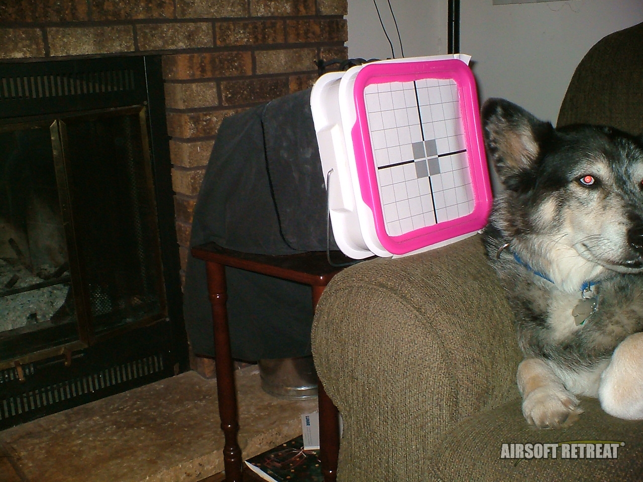

Then you can clip a target over the other end by removing the lid frame made in the first part of this process, setting the paper over the top of the bucket and then clamping down the frame over the paper. This will pull the paper tight and hold it firmly.
When set on a surface in preparation for shooting, the pillow case should be allowed to dangle free of any obstructions for at least 6 inches behind the bucket. When you fire at the target the bbs fly down this channel, strike the loosely hanging pillow case. This billows the case out slightly, absorbing the impact, and the round falls into the bottom of the case. The reason you need the 6 inches of clearance is because if you don't have this clearance the rounds can strike the obstruction causing damage to the surface and/or ricochets back out toward the shooter.
