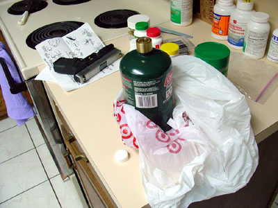

    Propane is highly economical as an airsoft gas. I picked up a small can of Coleman Propane Fuel, probably designed for gas lamps and small cooking grills, from the local Target for around $2.50. The net mass is 465g, so given a density of around 583.074kg/m^3, the can contains about 7.97x10^-4 cubic meters of propane. So, the cost if $2.50 for just under 800ml of airsoft gas, which makes propane about 3 times less expensive than the cheapest airsoft green gas I could find in the United States. And you don’t even have to have it shipped to you. Apparently, in Canada, obtaining green gas is much more expensive than in the US, which would mean an even greater ratio.
    So, for the average US airsoft player, the best price for a 1 liter can of green gas will probably be around $9-$12 with shipping. The Airsoft Innovations adapter nozzle is being sold for $30 USD shipped. Propane is around $2.50 for a 800ml can. Throw in $3 for a bottle of silicone oil, which will need to be added to the magazine before using propane. Which means (and I’ve done the math for you here already), the adapter covers its own cost after 6 cans of green gas, assuming the cost of $9. I’ve certainly used more than that in the past few months.

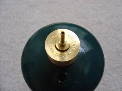

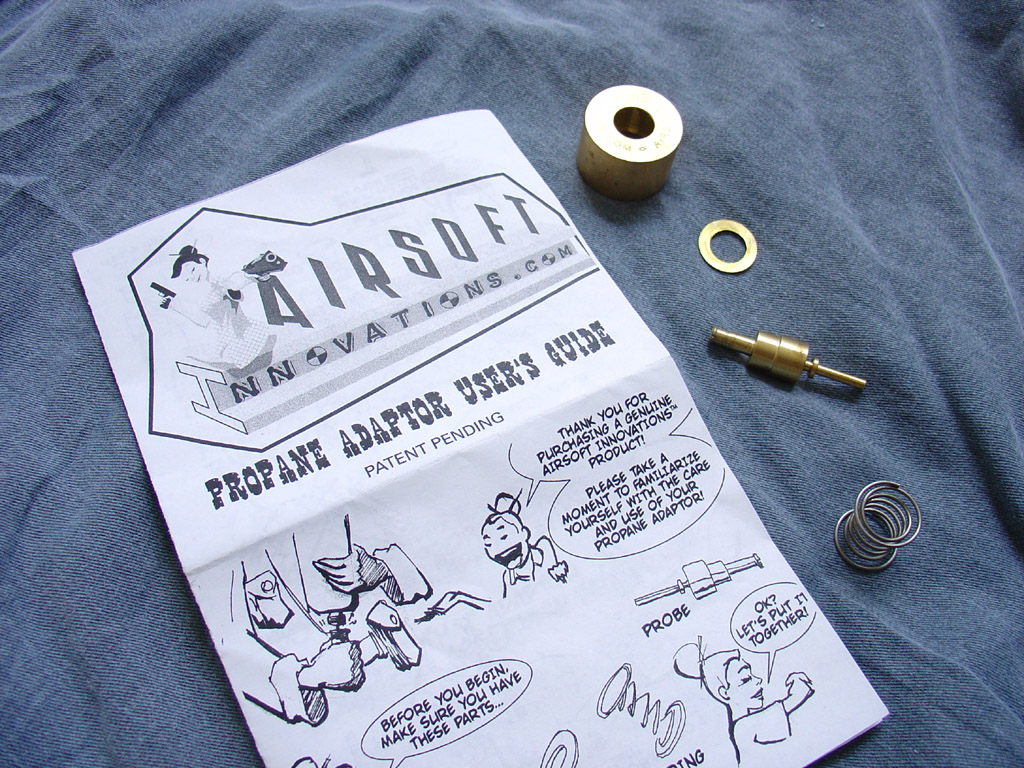

    I am really fairly impressed by the unit itself. It is made of very nicely machined brass and is composed of four pieces. There is a large threaded fitting that screws onto the propane tank, a washer and spring which go into the fitting, and the nozzle, which is inserted last. The four-piece design seems to be to ensure the widest compatibility with various propane tanks, as well as to allow easy removal of just the nozzle to ensure safe transport.
    Installation is completely inconsequential. A very smart monkey could assemble it in around 15 seconds. Since it may equivalently take the average airsoft player upwards of a minute to figure it out, I’ve included a quick video demonstration, omitting only the step about placing a drop of silicone oil on the nozzle (I’d just done that right before), Check the media section at the bottom for the video.
    Along with the nozzle, I received a very nicely illustrated manual documenting installation and use, as well as some hazards and precautions. And a stereotypical Asian woman without a nose. But, being a fellow Mongoloid (big M, not small), I wholeheartedly approve. In fact, the illustrations are very good, and the whole production is really much better than I could have expected from something like this (especially after wading through all those little colored paper strips that come with Japanese aftermarket accessories and upgrade parts).

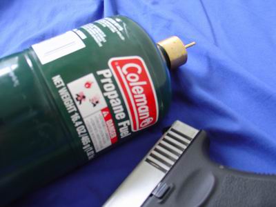

    The nozzle seems to provide as good of a fit as any green gas bottle when it comes to filling. I don’t have a KJW or HFC magazine on hand to really test it, but I’m sure that it’ll achieve the same no-leak seal with those guns as the typical green gas bottle. Oh the whole, it offers a much less leaking than hand-cut plastic nozzle adapters using duster gas. It is also long enough to reach into the fill valve inside the bumper pad of my Western Arms V12, a gun which has had problems fitting various other gas bottles in the past.

    Well, how does it shoot? The answer seems to be: great! It was late at night when my friend James and I got back with the propane. Since, we wanted to prepare for any possibility (i.e. my bursting into flames and running about as a human torch), we locked his dogs (see picture) inside the house and readied the fire extinguisher. Installation took the requisite 15 seconds, and then we were ready to go. I used one of my KSC Glock 19s for this first run, since it was equipped with a metal slide. Results were highly satisfactory. In fact, I felt that the propane was producing greater blowback than my green-and-white camo green gas. I was using the one G19 mag whose fill valve leaked slightly with green gas. With propane, the leak was tangibly greater. I noticed the same with my G26 short mag. This goes to indicate that the propane perhaps produces more pressure. Without a chronograph, I could not measure muzzle velocity, but results from coke can tests were similar to those with green gas. The propane also seems more resilient to the effects of cooldown when compared with green gas. However, the differences in these characteristics can probably be attributed to differences in purity, odorants, and lubricants.
