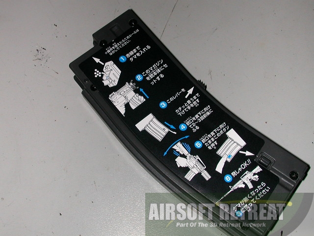

The new magazine system that Marui chose for this gun is a 180 round resivoir magazine with 28 shot capacity. The 28 round capacity can be replenished by the resivoir without taking the magazine out of the gun. My best guess as to why Marui chose this over their usual clockwork AEG Hi-Caps is that with this new system children can not pelt each other with 100-200 rounds continuously this would lower the risk of potential injuries and damage that the gun can cause.

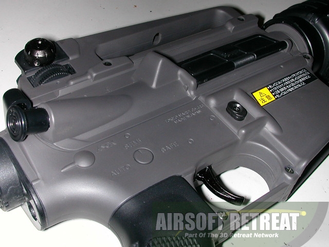

The gun is made up of almost all ABS plastic but the TM M4a1 B is very well built the only weak point on the gun is the front barrel, the reason for this is becasue the inner barrel doesnt go all the way through so its just a plastic tube waiting to be sanpped in half. One good thing about this is that you can chop the outter barrel to Commando length and you wont have to do any mods to the inner barrel. The rest of the gun is strong and strudy, the body is made up of two halves (left and right) instead of the full sized M4a1's more realistic upper and lower design. All the trademarks are in the same places as it would be on the full sized M4a1, even the ASGK and Tokyo Marui Ltd markings.

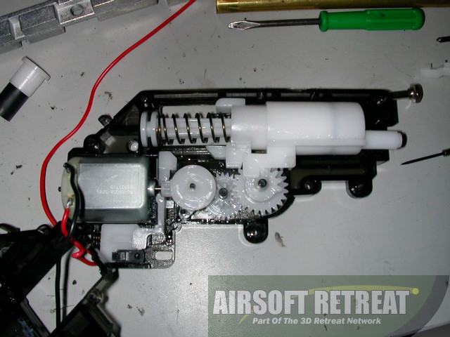

In a step above all the mini electric guns the Marui M4a1 B has a full gearbox that is very much like the larger AEG counter -parts. The gearbox is smoke colored plastic and all gears are nylon with the exception of the pinion gear which seems to be made of PTFE(teflon). The motor is enclosed inside the gearbox and position horizontally in the rear reminescent of the FAMAS and P90 gearbox.
Want to see it in action?
Click here for the 4 meg Quick Time movie.

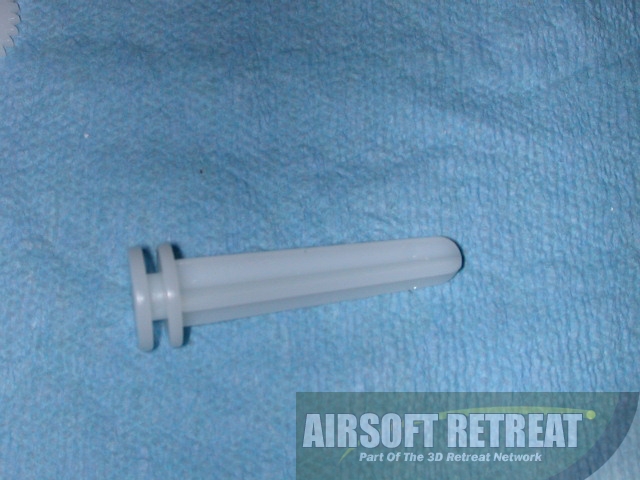

It seems like Marui has been paying attention to all the gearbox development around them and have adopted some new designs for their newest (and smallest) mechabox. The pistonhead is vented with holes like all aftermarket pistonheads but the major difference between the full sized gearbox and the Boys is the simplification of the feeding mechanism. The design is similar to Systemas new LE high end rifles with the cylinder , cylinderhead, nozzle and tappet plate fused into a single unit.

The gun is made to use only .12g bb's, I tried .20's and the magazine had problems feeding them. I think the mag spring is too weak to properly feed them because if I load about 15 rounds it will shoot but if I try the full 28 rounds it will start to misfire. Either way .20g bb's are not a good idea, range and power suffer dramatically with the heavier bb's. With .12g bb's the gun shoots perfectly and I havent had a misfeed or jam with them. The reservoir magazine takes some getting use to, when you get it down you can replenish the mag in under 3 seconds. Firing off all 180 rounds takes under a minute, if you plan on playing games with this gun I would suggest a few extra magazines because with the M4a1 B's ROF you will be going through BB's pretty quickly.

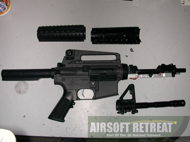

At first glance the gun does seem like it can not be disassebled but upon closer inspection I found it to be indeed possible and actually very easy. The hardest part is getting the battery case out, this requires splicing the wires or taking off the metal contacts on the battery case. After that you need to remove the mock chargin handle rear sight and outter barrel, the rest is unscrewing screws and splitting the body in half. The first time I did this the internals kind of spilled out but with the simple layout I was able to put every part back in its proper position without much effort.
Heres what I ended up doing to my Marui M4a1 B:
  • Upgraded Spring: 200fps w. .12g bb's. The spring is the thinner spring pistol type found in Marui pistols. AEG springs are too wide to fit in the piston.
  • Longer Barrel: I used a AEG barrel and modified it to work with the new hop unit. It also increased front outter barrel strength.
  • Rail System: Upper and lower rails can be bolted or JB Welded on, I used a M4a1 upper reciever rail for the lower and a G36c short rail for the upper.
  • Battery Pack Modifications: I switched out the AA battery in favor of a small 8.4v 600mah battery. With the new 8.4v (stock is 7.2) ROF is faster than a stock full sized AEG. I had to use a M4a1RIS mock laser compartment to hold the battery.
  • Camo Paintjob: Simple 3 color desert tiger stripe camo.
  • Commando Length Outter Barrel: Simple hack job.
  • Removeable Flashider: Modified Plastic M4a1 flashider can also use G36C flashider
  • Disabled Secondary Pistol Grip Safety
