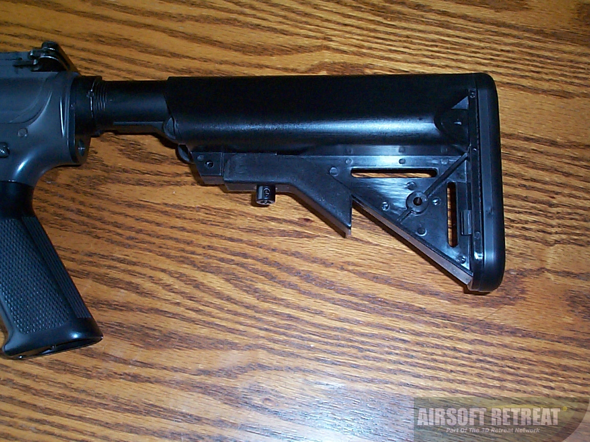

The most dramatic thing about this stock is that which makes it a ‘Crane’ stock. The standard issue adjustable stock has the bare minimum amount of plastic and parts to make it function as a shoulder stock. However, the failing that the standard stock has is there is not really a good surface for the shooter to get a cheek weld on. When the shooter is aiming for a shot, the natural resting point on the standard stock is a tube.
The Crane Stock seeks to correct this by making that round tube into a shape conducive to a cheek weld. There is an area running the length of the Crane that sticks out an extra inch, providing a small, 45 degree platform for one to rest the face against when aiming. This makes shooting more comfortable and natural. How well does it work? Let’s get it on and find out!

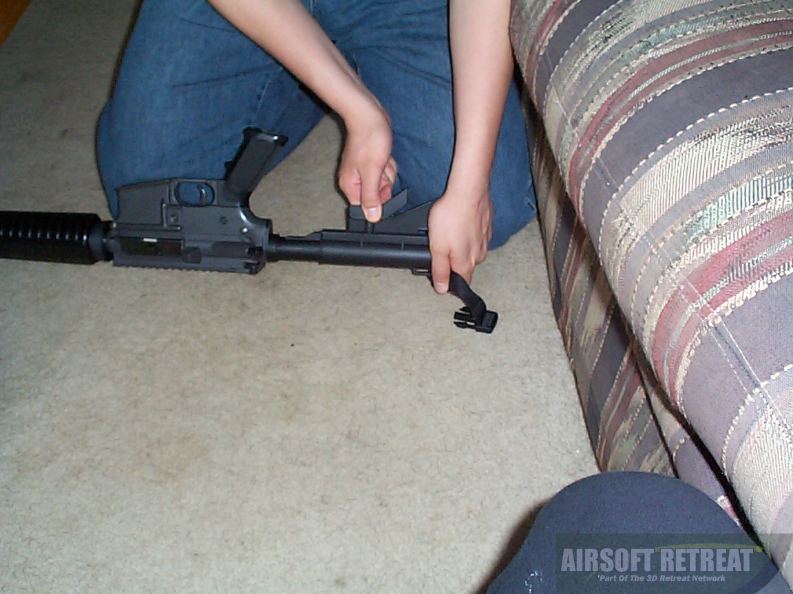

The installation for both the grip and stock took just under 10 minutes. While the installation is pretty simple for both items, the grip does require a couple tools. A long neck Phillips head screwdriver and 1.5 hex driver. Installation of the Crane stock was very easy on the TM M4a1. Even someone not very mechanically inclined should have no problem at all with it. All you need to do is pull down on the adjustment lever and side the original stock off. To install the new stock pull down the adjustment lever and side it forward on the stock rail. That’s it. Simple, sweet and ready to rock.

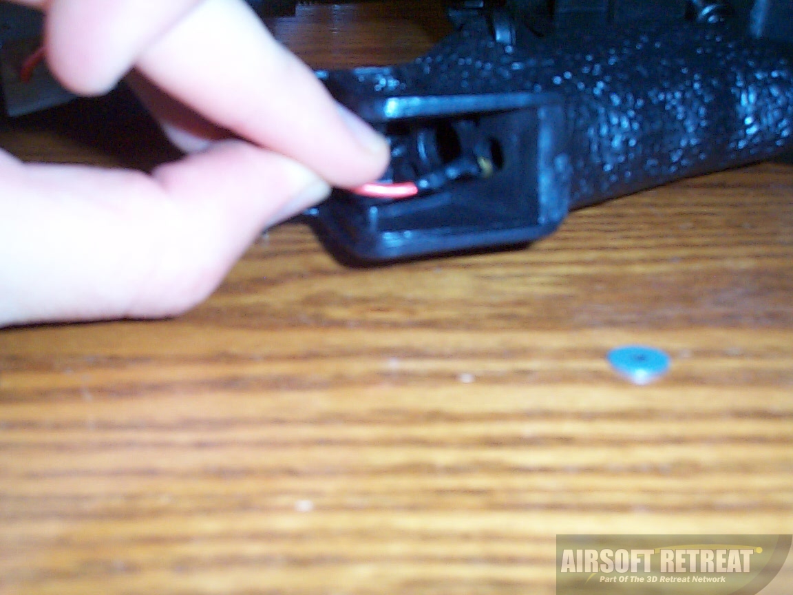

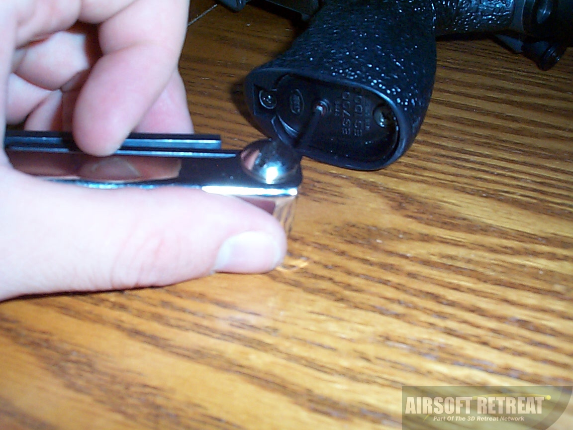

To begin, find the 2 screws at the bottom of the grip that hold a plate that holes the motor in. These will need to be removed. When you remove the plate, be careful there is a shim that is used to push the motor up into the gears. Be sure not to lose this piece and make a note of how it fits in there. Next remove the negative and positive cables from the motor. After you pull the motor out make a note where the negative and positive cables lay inside the hand grip because it can be tricky to reinstall the grip if you've forgotten how these wires route inside the grip.
There are 2 more screws that connect the hand grip to the gear box that need to be removed at this point. After the screws are removed the hand grip should slide off. Be careful when sliding off the hand grip not to pull or strain the positive and negative cables. Gentle, firm pressure should be used.
Now that the grip is removed you can install the new one. The new grip has 4 holes in the top. The inner two are for the positive and negative cables and the outer 2 are for the screws to hold the grip to the gear box. Pull the negative and positive thought the 2 inner holes. Put the screws for the grip in the other holes and reattach the grip to the lower receiver. Be careful not to over-torque the screws as you could strip them out.
Then place the negative and positive cables back in place like there were when you first disabled the grip. Place the motor back in and connect the positive and negatives back to the motor. When you place the plate that keeps the motor in make sure you have the shim too. Screw back in the motor plate. Your new grip is now installed.
You will have to tighten the motor adjustment screw with the hex driver until the motor is siting firmly against the gears in the gear box. This may take some time to get right as you want the motor to be positioned tight against the gears but not so tight as to keep them from freely moving.

The stock’s cheek rest is an excellent addition, allowing one to find a nice comfortable place to rest one’s cheek when aiming. This was particularly noticeable during long, stationary periods where one is holding a sight picture for an extended period. It’s adjustment was smooth and silent as well.
