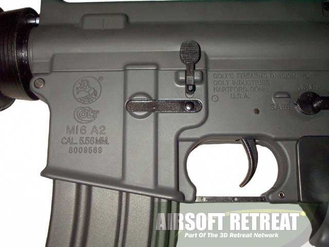

Now, on to the good stuff – I’ll start off with the question on everyone’s mind: “What does the receiver look like?”
As you can see, this review sample came to me with trademarks intact – while I’m not normally too keen on importing replicas without proper trademark covering, it is great to have unaltered trademarks since they look so nice in pictures! Taking a look at the trademarks, I first thought that these were an exact copy of those found on the Tokyo Marui M16A2; however, after a chat with Jack Ma of The Q Project (www.theqproject.com), I learned there are very subtle differences. The color, texture, and build quality of the receiver is identical to the TM M16A2 and very much what one would expect from a Tokyo Marui AEG.

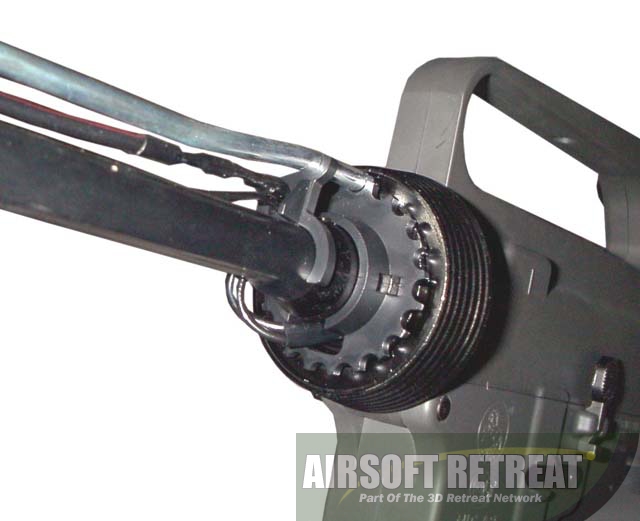

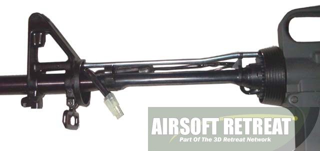

One of the biggest improvements over existing designs that is introduced with the M733 is the redesigned front barrel assembly.
The joint between the receiver and outer barrel assembly has been significantly strengthened and the infamous barrel wobble problem decreased, if not solved completely. You should also see the new gas tube which runs beneath the handguards, not only mimicking the look of the real M733 but also adding another strengthening element.
Gone from the front barrel assembly is the clunky fuse assembly of the M4A1 and M4 RIS. Instead, Tokyo Marui has chosen to use an inline fuse holder, painted black, which is held in place with a reusable zip-tie. This was necessary because of the smaller internal space available for battery storage in the M733’s slimmer handguards.
